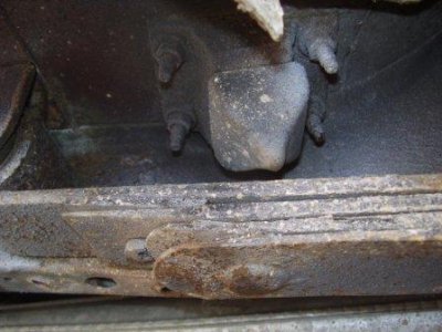

    Couple of pictures of original unmolested snubbers on '67 GT350 #2751

    Just checked mine and they're exactly like Skidado's.

    Fellows, Be careful of what you are discussing. Two different parts are being interchanged in this discussion. 1967 Shelbys received "rebound dampers" at the factory and NO traction bars. See the 1967 Shelby specification sheet. It
    also goes on to mention Dealer Installed "traction bars.
    All '65 Shelbys and the first 252 ( carryover ) cars received "overriders".
    '66 Shelbys initially received overriders, then "underriders for the rest of '66
    production. Both types of traction bars were provided by the Traction Master Company. The Dealer installed traction bars were also sourced from Traction Master. This is not to say other companys did not make traction bars, but to state that Traction Master Company was the official vendor of traction bars
    to Shelby American.

    The original Rebound Damper is fine if you are going concours or just want to be OEM. the pieces from Branda appear to be longer making for quicker contact and constructed of Polyurethane for improved durability.
