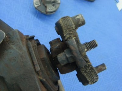

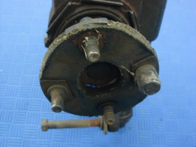

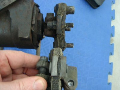

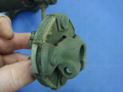

  2. Bob Gaines
    You hit the nail on the head or in this case shaft. It was 5/1/67 when that change was made so the real late built cars had the rag joint or seperate steering box and steering column shaft.
  3. Bob Gaines
    Rod, I reread my previous post and I wanted to clarify that the there is a rag joint used on tilt columns that is different then a rag joint used on a non tilt columns after 5/1/67.On a Mustang based 1967 Shelby car after 5/1/67 you would use the Non Tilt rag joint .

    Hi Bob, do you have any pic's of the different rag joint used ?

  14. Bob Gaines
    That statement means that the wheels and tires were supplied by SA(customer) to the Ford assembly line. I think it is more of a clerical issue because there wasn't a SA truck taking the wheels and tires to the San Jose plant. They were being delivered direct from the OEM Vendor to the plant just like every other part . If I remember right A similar "Customer Supplied" statement is on 68 and 69 build sheets at the bottom were they address the tires.
    here are some pics of the two types of rag joint the one that is on the steering box is used on 67,68,69,70 Shelby with out tilt. It connects by bolting a flat flange from the steering column to the rag joint.The separate one with splines on both ends is for tilt . It attaches to a tilt column which has a splined end on the steering shaft. The tilt joint was used on 68,69/70 Shelby's with tilt. I hope this helps.

    Thanks Bob, i have both in different cars. I always thought it might have been a running change at Ford, so thanks for that info. :thumbup:

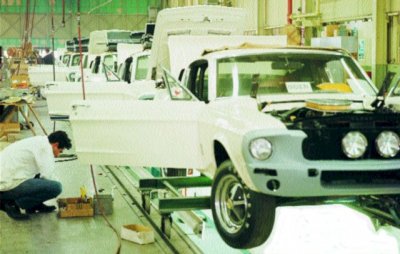

    Hi everybody on this thread.Just had a look for pictures and if you have the book Shelby's Wildlife by Wally Wise check out page 169.It shows an LAX lot full of cars in all different colors waiting to be converted into Shelbys and all the visible wheels are Magstars..one more clue to our puzzle!!:) This is not a magazine dressed up/set up photo,as Snakepit warns,and I agree magazine photos are not the best source of accuracy.Has anybody seen any 67 pictures from inside the hangers during assembly?Thanks for looking :)

    Here you go.............
    1967 GT500 #00231 which is pictured in this photo of the 1967 production line at the West Imperial Highway
    plant Los Angeles, CA." Photo-author unknown.
