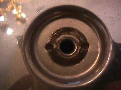

    I have an air cleaner that came off of my 65 K motor and I have doubts about this being the correct factory issued air cleaner lid. I am sure that the bottom is correct but am not sure about the lid because it doesnt have the dimples for the wingnut. All of the concours correct reproductions have the dimples. This lid looks correct other than the dimples. Can anywone shed some light on this? I will probably have this one rechromed if it will be correct. Thanks for your help!:cigar:

    It looks real to me... almost all repros... and even the "concours correct" ones look like fakes from 20 feet away.. (to me) If I was you I would use it.
    I looked through Bob Mannel's excellent book "Mustang and Ford small block V8" and I couldn't find the answer... In my fuzzy memory I seem to remember they can be both ways..
    But I have been wrong before.
    Jimbo
  3. Snakepit
    As far as the lid goes I would think it is an early reproduction rather than an original.
    You mention the case is original... I take it you found the date on it?
  4. 429Scott
    429Scott Member
    Apr 9, 2006
    Hi, if you have any doubts about the air cleaner lid you should weigh it. Original lids are 24oz +/- .5. Repo's are not near the same weight, about 15-18oz. Maybe they made some early ones with no dimples but the weight is definitely the best test I have found. The bottom is definitely original, even if you don't find a date stamp, never saw a repo with the correct nipple for the closed crank case ventilation like you have on your bottom tray.

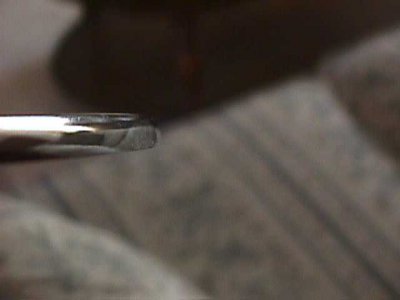

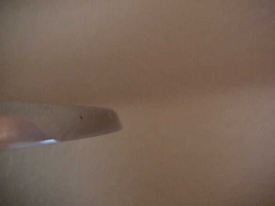

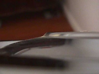

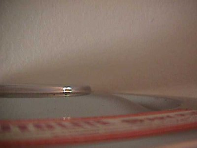

    Ok..got some pics..need some help now...the first four pics in this post are of an air cleaner lid that is exactly like the one we have that came with a 67 dated base..it wieghs about 21.9 ounces..notice the little indentations for the wing nut are really close to the hole..also the top of its lip has a tall sharp 90 degree angle on it and the side edges flair out at at 30-45 degree angle....is this factory correct 65,66,67?

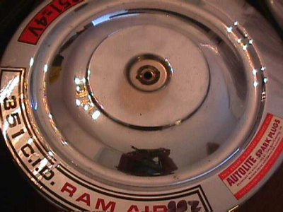

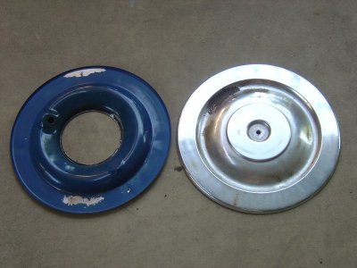

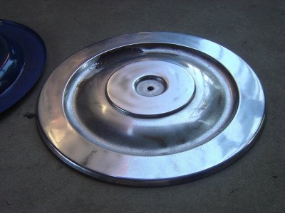

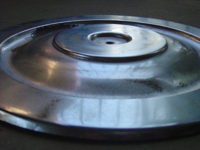

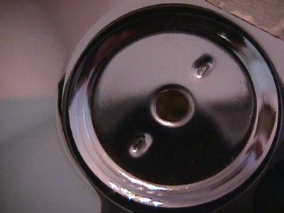

    Now here are some pics of another lid...much heavier ..about 27.5 ounces
    Notice the top edge is not as tall and has like a 30 degree angle and the outer edge has a 90 degree angle that..notice the wing nut indentations are not as close to the hole opening and also the hole is a bit smaller than the other lids..at least it looks that way..so what is this lid for???

    Both my original lids, which includes the one OE to 6S1757, look like your first set of pics.

    thanks Dave...66 and 67s should be the same tops then correct?
    I wonder about the second top we have...Its just super heavy and of course you can see the difference in design from the pics of the top bump and the rim against the first pics...

    65,66 and 67 LIDS (bases different) would all be the same . The last picture you posted is strange to me and not one I have seen on any year Shelby.

    the one we weighed that appears to be the correct one like yours weighs 21.9 oz and our original that we rechromed weighs 23.3 oz // now granted our scale could be out of calibration..a touch...
    Thanks Bob for the input!! I compared it to a pic on ebay of a current repop and it looks identical..but it sure is super heavy 27.5 ounces.

    I'll try Jimmy but it may take a little while, don't have access to a scale accurate for light weights. I do think the lower set of pics looks like one of the newer repops.
