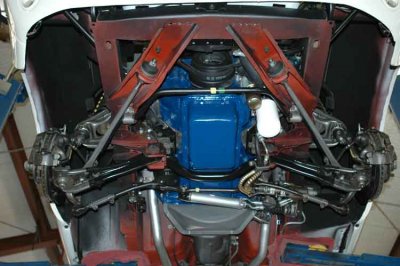

    You answered every question I asked to the fullest. The way you described the suspension reminds me of a pic I saw of a restored 67 Shelby at Restorations By Randall. Looking at this picture it looks like he did a fantastic job and the way you described the answers to my questions is very close to this pic. Looking at this pic would you say this is a good example?
    And yes you answered the question correctly about the power steering hoses.
    Thanks Bob!
    Jim#3000
  4. Bob Gaines
    Jim, David R. is a good friend and I have advised him at his request in the past. One more thing the P/S hose wrap doesn't look very good unless it is plated instead of painted. ether way be careful taking it off because it is easy to bend and will not look good when it is put back on unless it is uniform in appearance (not bent up). The best of luck with the install.
