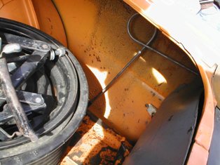

    I have a 69 GT500 that I don't think ever had the fuel vent recall done. Can someone post a picture?

    I think this is what you are looking for....It is a nipple screwed into the filler pipe, a rubber hose, a looping pipe and another small rubber hose. I have a drawing of the system, but you will have to email me for that. Coralsnake68@hotmail.com
