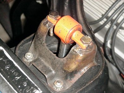

    Somewhere there has got to be a distinction between good fake parts and bad fake parts :alarm: ... Once again it is the buyers responsibility to make sure he gets what he wants.
    So...
    Are these shock towers fake or original? (not for sale on ebay or anyplace else)
  10. TLEA
    Hard to tell with shock in place as inner hole is usually a giveaway but I'm guessing they were made in someones garage. Washer looks a little thin
  11. TJinSA
    TJinSA Well-Known Member
    68
    Fake the washer is too thin; welds too cold, focused too heavily on the tower and double wagged indicating the washer is likely not hardened, nor as thic as the tower. The original washers were off the shelf, primarily used by the powerplant folks.
