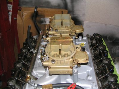

    Here are the carbs that are on my car now. I can only supply one picture at a time due to the size requirements
    brian
  12. rsimkins
    rsimkins Well-Known Member
    449
    Jan 13, 2006
    Eastcoast USA
    Brian,
    Can you read the list numbers on the air horn?

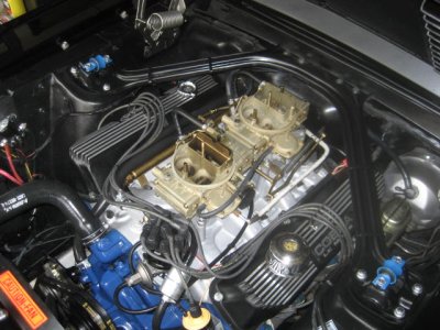

    Another shot of my carbs on intake manifold

    Roy,
    I will supply them later this week when I have additional time. Again, they are not original to this engine. I believe he exchanged my original carb and one that was on my car for these two carbs that you see now

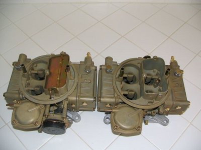

    Another shot without air cleaner
