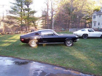

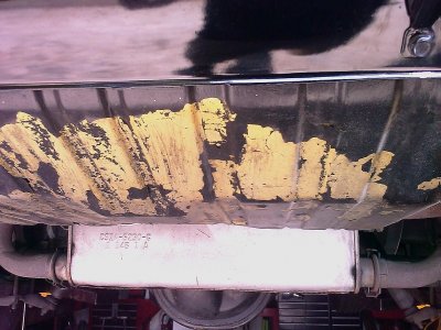

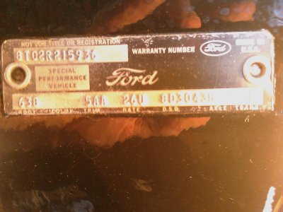

Gentlemen thank you very much, I will be attempting this :blush: next weekend and will post the after pictures. Attached is the before. ( yes with a 63 split window stingray poking its behind into the picture. Those bowties never quit ) Steve By the way how do you embed the pic into the post. I can only attach it. By the way looks like I'm in line to pick up a blue/silver 08 GT500KR. (got the call today) LOL, When i bought the car I was told that it had been painted a different color than orig. I never put much thought into it. But after checking out coralsnake's website I went back and looked at the door plate and low and behold there is no number in the paint block, further inspection reveals the code WT-6066 on the fender paint. So i guess it was one of the "special paint cars" I guess I have a long road of disassembly/restoration to go on. Pete how should I go about getting the yellow? I put in an email to dupont today with the codes on your website. I'm waiting for a response. you can see from the gas tank what the orig was. Sorry about the quality of the pics.
Stephen, A body shop supply store or paint vendor should be able to come up with the exact color by cross referencing those codes. If not, I have some more. Welcome to the exclusive "special paint" club. I have run across several special paint cars that were repainted and "lost". It is good to have you back. Look for some updates to the website in a week or so. Pete
Pete , how many of these special paint cars are still around? (not crashed or burned), and was this a car that you were looking for?
Stephen, There are 159 1968 Shelby Special Paint cars. There were 144 yellow cars (94 fastbacks and 50 convertibles). Your car (#4166) is 1 of 86 GT500KR fastbacks. 8 were yellow GT350 fastbacks. I am looking for all of them. I am also contributing this information to the new Shelby Registry. I can do a count, but I would guess around 80% are accounted for. There are several more that have some information or paperwork floating around. So, it's pretty hard to find one I am missing. Do you know your original dealership? My book is not handy. Only a small percentage of the cars have no information at all. I can tell which cars are yellow, because there is only one missing non-yellow car. Oh, that yellow on your tank is from a prior repaint, so you must be going for number 3.
