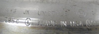

    Can someone confirm if the following manufacturers markings are correct for a 66 Hertz Magnum 500:
    14x6 JK UNISTYLE
    795C C1 Made in The United States
    Want to be sure before I send them out for restoration!
    thx
    Lee
  2. Snakepit
    ALl mine have tires mounted on them at this time but I do have a picture of that area that was provided by another and it matches what you posted except the very last
    You list C1 they show a large C with a 6 inside
    Hope this helps

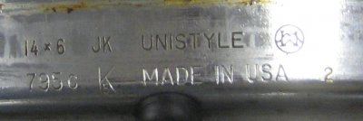

    Hertz Wheel Markings - pictures
    Jeff,
    Yes, the 1 is inside the C. It appears to be a date code or inspection stamp as all the rims have different vaules all stamped with a big letter that has a small number within the boundry of the letter. I also have 2 different stampings. See attached pictures.
    thanks,
    Lee
  4. Snakepit
    Thanks for the additional pictures... as I mentioned before it does appear that they are what you want.
    Good luck with the plating and remounting.... let us know how it goes
