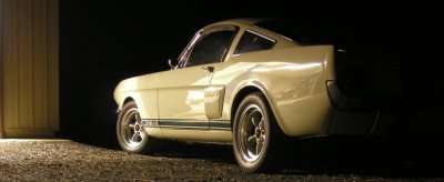

    Hi Lashss
    Nice car!
    If you drive a car like this a ployuretane motor and transmission
    mounts is a must. My oprinion. Don´t forget the loss of power
    because of soft mounts. Thats why real race cars weld their
    engine in stiff so they don´t even move a pit! :thumbup:
    Bye Jerry

    Jerry, thanks...leaning that way.
    Thank you for the compliments...love this old wreck!
