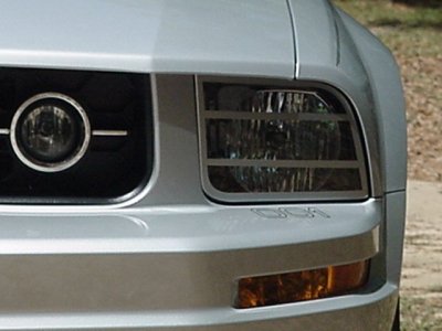

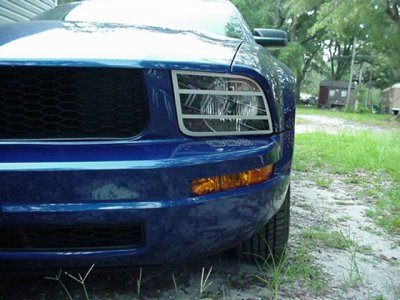

Very COOOOOOL. The orange really changes it a lot as does the Wheels. Incase you might be interested..... I designed a cool Head Light Decal that I produce in Silver but I could also do it in Orange if you want to try it. Send me a PM if you are interested. I own MESTENGO F/X, Inc. (formerly MUSTANG F/X) www.mestengofx.com. David.
