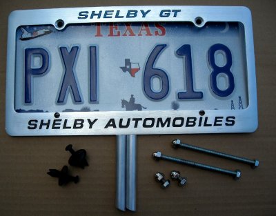

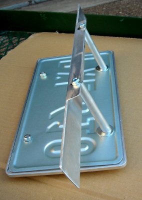

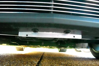

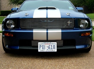

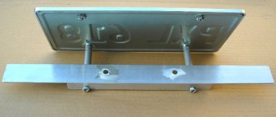

    Here is one I made. No holes required! It goes thru the push pins at the bottom of the splitter. The top brace is about 18" wide. It fits between the splitter and lower splash pan.
