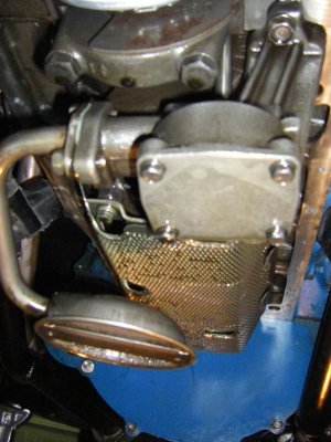

    The local Ford dealership can no longer get them and recommended an auto parts store. When I look in the shop manual and look at the one I currently have they look very similar, I took a picture and hope that someone can tell me if it looks correct for a K code engine.

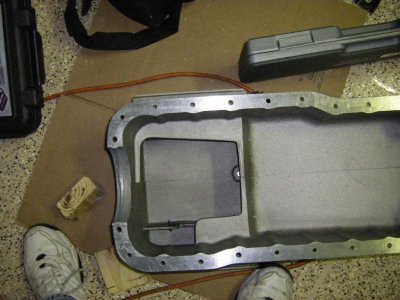

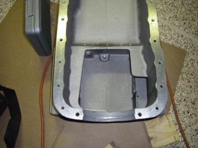

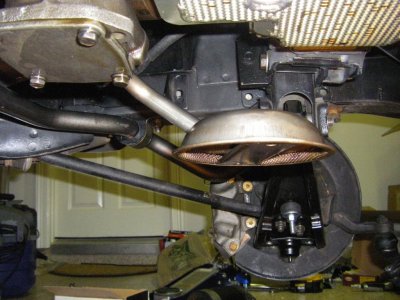

    It is hitting on the oil pickup tube filter (round part that has the screen in it) towards the back of the engine. The oil pan is basically square where the pickup tube goes, it has a lip that points to the front of the engine, it is hitting on that by about 1/2". Attached are some pictures, the first one shows the lip that it is hitting on (directly above the drain plug), the second picture shows the lip from the top. The last picture shows a side view of the oil pickup tube and the round part that has the screen in it, that is what hits the lip in the oil pan.
