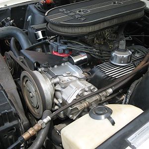

  4. TLEA
    Part # is C7AE 8952 A
    Tim
  5. JSOHC
    JSOHC Member
    18
    Sep 9, 2007
    Thanks Tim for the picture. can I have that one? LOL.
    Jack in Ga
    :noway:
