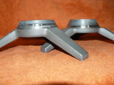

    I've attached a pic of what I have goin' on.
    Notice the shiny witness mark on each spinner. Although the taper of the spinners show signs of mating with the taper of the wheels, it appears that there's a narrow concentrated contact surface...the shiny ring.... between wheel and spinner. Shouldn't I be seeing evidence of a broader contact between the two?
    So far I don't see that the spinner is bottoming before the wheel is firmly clamped but it looks very close on the "thin" spinner. That is, the flat inside face of the spinner is very close to contacting the wheel.
    I wonder what the heck I've got here?
    Thanks for any additional thoughts on the matter.

    My opinion, based solely on your photo, looks like two different types of after-market ones.
    Lots of things unknown could have happened over the past several decades. I have seen original wheels that were "remachined" as part of a cosmetic restoration. Even a tiny error in the angle of the seat cutting would change the way nuts, original or replacement, fit.
    It would be a good idea to check fits via scuff patterns with machinist's blue dye.
    KOs are one of the most commonly replaced items on 427 Cobras (and Cobras with pin drive). People just getting a car tend to hate beat up KOs. I have an aluminum nut from a 427 Cobra's original equipment, and several aluminum nuts from the same car as the first couple of owners replaced beat up ones with fresh ones occasionally. The parts cover the time frame of manufacture of roughly late 1964 through no later than summer 1968. (The first of several tool or design changes in aluminum ones I have studied and researched and the companies involved happened in mid 1968.) In my looking at cars and KOs (since 1983), original nuts ( versus service parts later - even from Halibrand) still on the car they left SAI on are extremely rare. Mid 1968 and earlier aluminum Halibrand ones machined for Cobras are scarce and when found are usually in pretty bad condition. Typically the pre-1969 ones I find are the best of the beat ones kept as back up spares and sold separately after their cars were sold. The late 1960s Halibrand steel ones machined for 427 Cobras are not super hard to find but they are different than the style they replaced also.

    Sorry I'm a little late on the topic - but I'm pretty sure what you have are front/back knock-offs. The 'flatter' ones would go on the front wheel(s) and the more angled ones go on the back. These would correspond to the difference in width of your front/back wheels themselves.
    Hope this helps.....
