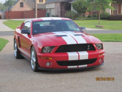

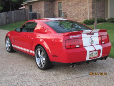

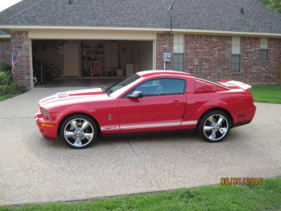

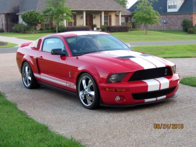

    Here are the pics of my car, Randall, hope this helps. I love em', plus how can you beat a combination of chip foose and carroll shelby.

    those look great on your car..very nice.

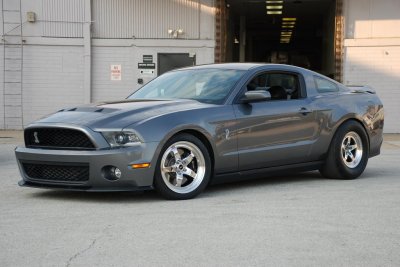

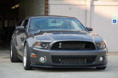

    Choice of wheels depends on your intended use.
    I wanted wheels that I could use at the drag strip as well as drive on the street. As I searched for wheels that would serve this need I found out that few wheels met this criteria when paired with a 2010 GT500.
    I finally found that Weld Wheels, in KC, made a 15x10.25 rear and 18" fronts. 18" is the smallest wheel that can be placed on the front of a 2010. I have 18x7 for the front.
    The 15" rear wheels allowed me to place large, high profile tires on the rear which is desirable for drag racing. I mounted MT 325x50R15 tires on the rear.
    PS: The suspension has been changed and the car lowered. Also, the front tires in the photos are 18x5. They were mounted for a photo shoot.
