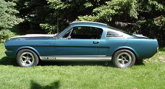

    I have 205's on the front and 215's on the back. 15X7 torque thrust D's.. I have all original "to the car" fenders, and they survived this far without rolling them so I decided to get as much rubber as I could in there without rolling the lip. I tried 215's on the front and they were very close.. I think with the wheels cut all the way .."backing up" would have bent metal.
    caps on torque thrusts.. ....Nah
    jimbo
    BTW.. I have 65 size GT350 rocker stripes (white paint) and logo (white vinyl) on this car. It was a pain in the butt to do and I think I had a few extra GT350's made......

    Your wheels and car look magnificent!
    I can't see from the pictures you have posted the details of the hub. To cut the small ford bolt pattern into the "old" wheels the broach also cut into the hub to make room for the washer that went underneath the lug nut.. It was a real pain to try and polish that area because of the gray paint/bare magnesium contact.. (sharp line).. Do you know how much your wheels weigh??
